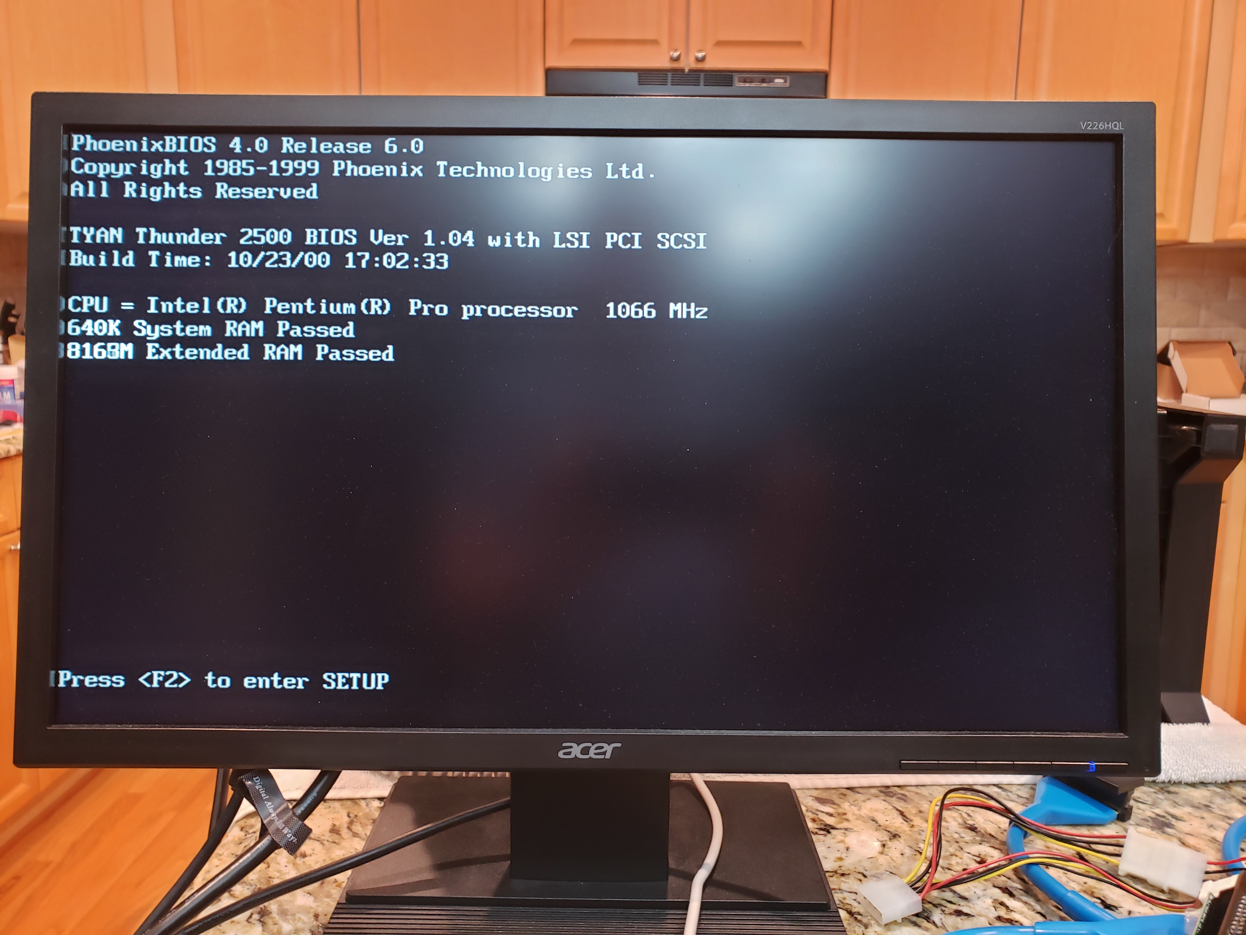

Based on my testing, this doesn't look to be a BIOS-related issue. At least, not one that I've found just yet. I have found that this board is profoundly picky about what slockets are used. And since this board prefers the older slockets, you'll have to do some modifications. In particular, you'll have to reroute the BR1 signal... even if you want to use Coppermine CPUs.
I had luck, following this guide:
http://patswayne.com/megamod
Please note, there is one recommended deviation. The author recommended having the 370SPC in slot #1 and the Super Slocket III in slot #2. This does work. System POSTs and boots to DOS (haven't tried Windows yet). However, I could not get greater than 4GB to work with this configuration.
For grins, I tried swapping slockets. To my amazement, the board was able to detect all 8GB... with dual Tualatins
I still have more playing to do and will update you on my progress. But so far, things look promising.
System:
POST:
BIOS:
-Brian

Hey Guys,
Sorry for the delayed response. I finally got around to finishing this project.
I got Tualatins working with my Thunder 2500. For kicks, I installed Windows 2000 Advanced Server, with PAE enabled. The system fully recognizes 8GB of memory. I believe this is the first Tualatin-based system with 8GB of memory.
-Brian
